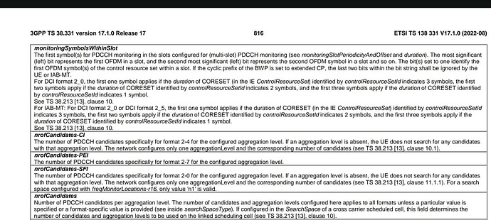

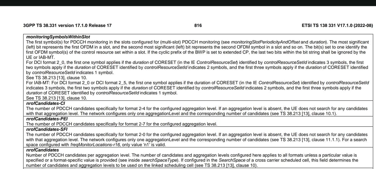

But here 38.331 just talks about the definition of involved parameters on RRC layer.
This is not relevant to the below statement:
“As per standard it did not allow that CORESET is starting before end of the previous occurrence of the same CORESET.”
Hi dear, you didn’t read it carefully… For more clarity you can check 38.213.
Sometimes 3GPP do not write things in straight words.
We need to deduce meaning from it.
I didn’t check 38.213, but I didn’t find relevancy here in 38.331 with this statement…
Can you please help me to find the part which i missed in 38.331 whose snap you had shared?

I am talking about this snap where 38.213 mentioned.
Yes, its as per standard only, but you may not find straight sentence :grin:
