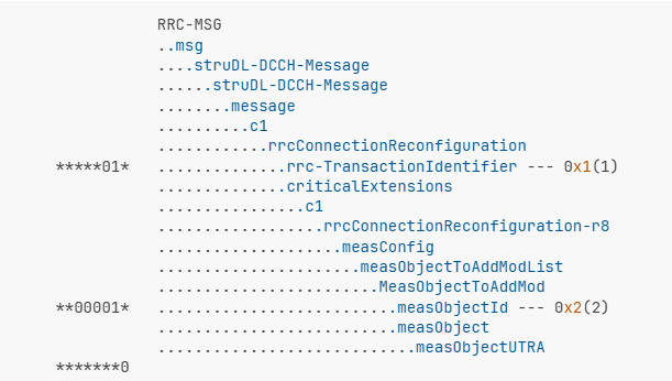

                   RRC-MSG
                   ..msg
                   ....struDL-DCCH-Message
                   ......struDL-DCCH-Message
                   ........message
                   ..........c1
                   ............rrcConnectionReconfiguration
        *****01*   ..............rrc-TransactionIdentifier --- 0x1(1)
                   ..............criticalExtensions
                   ................c1
                   ..................rrcConnectionReconfiguration-r8
                   ....................measConfig
                   ......................measObjectToAddModList
                   ........................MeasObjectToAddMod
        **00001*   ..........................measObjectId --- 0x2(2)
                   ............................measObjectUTRA
        *******0
8 >5C 01011100
9 >33 00110*** …carrierFreq — 0xb86(xxxx)
011
10 >C1 11
* …offsetFreq — 0x0(0)
…cellsToAddModList
…cellsToAddModListUTRA-FDD
…CellsToAddModUTRA-FDD
11 >06 00000*** …cellIndex — 0x1(1)
*110
12 >38 001110
…physCellId — 0x18e(398)
00
13 >39 001
…cellIndex — 0x2(2)
11001
14 >20 0010
…physCellId — 0x192(402)
…reportConfigToAddModList
…ReportConfigToAddMod
01011 …reportConfigId — 0xc(12)
…reportConfig
…reportConfigInterRAT
…triggerType
…event
…eventId
…eventB1
…b1-Threshold
…b1-ThresholdUTRA
00
17 >40 01000
…utra-RSCP — 0x3(3)
000
18 >AD 10
…hysteresis — 0x2(2)
1011 …timeToTrigger — ms640(11)
01
19 >97 1
…maxReportCells — 0x4(4)
0010 …reportInterval — ms480(2)
*****111 …reportAmount — infinity(7)
…reportQuantityUTRA-FDD-r10 — both(0)
…measIdToAddModList
…MeasIdToAddMod
*01
24 >81 100
…measId — 0xd(13)
00001 …measObjectId — 0x2(2)
25 >58 01011

The measConfig proves it: this is not an LTE inter-frequency setup at all. The measObject is measObjectUTRA and the reportConfig is reportConfigInterRAT / eventB1 with b1-ThresholdUTRA — the eNodeB is configuring the UE to measure UMTS (3G) neighbours, not L800.
So the UE is never told to measure L800 (the target EARFCN has no measObject here), which is exactly why target PCI 197 never appears in the Measurement Report. The B1 config present is for UTRA cells (PCIs 398 and 402 in this object are UTRA PSCs, unrelated to your L800 PCI 197).
What’s missing:
  • an LTE inter-frequency measObjectEUTRA for the L800 carrier (its EARFCN)
  • an A2 threshold to start inter-frequency measurement, plus a measurement gap config so the UE can go measure L800 (a different band from serving L1800)
  • an A3/A5 inter-frequency reportConfig bound to that measObject via a measId, with L800 PCI 197 reachable through the neighbour freq relation
Because none of that is in the measConfig, no LTE inter-freq event can ever fire → no HO → RLF → re-establishment finds L800 by cell selection (which ignores measConfig), which is why it attaches there directly.
So the fix is on the L1800 serving cell’s mobility config: the L800 inter-frequency measurement is not configured (or not being sent), only the 3G IRAT measurement is. Add/enable the LTE inter-freq measurement to L800 — the EUTRA measObject for the L800 EARFCN, the A2 start trigger, the gap config, and the A3/A5 report bound by measId.
