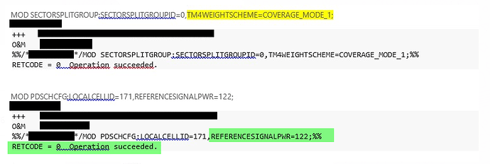

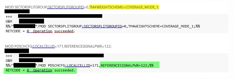

MOD PDSCHCFG:LOCALCELLID=171,REFERENCESIGNALPWR=122;
RETCODE = 0 Operation succeeded.
Prompt information
[0]Configuration data activating failed:(ErrorCode = 1977761760)Failed to check the power parameter configurations of the cell.

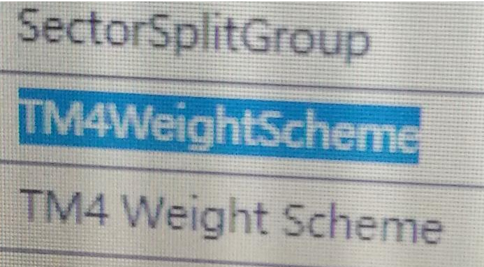

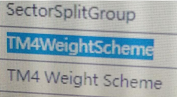

What value is TM4 Weight Scheme in Sector Split MO?
It is DEFAULT_MODE.
Change it to Coverage 1, and observe.
Note: Are you in eRAN 15?
I have changed it.
And it worked! Thank You my friend.
