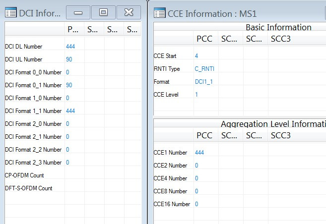

LTE too never seen 1 cce in KPI.
I dont remember seeing agg1.
You will see AGL1 in LTE. Max code rate for AGL1 is 0.925 in LTE.
Yes but rarely I seen in KPI, very less.
This is CCE1 in NR for DCI 1-1
Huawei never use AGL1.
Don’t know about the others.
AGL1 is not used for CSS, it is used for USS only based on UE coverage.
In 5G, Huawei don’t use AGL1 for USS. For CSS, offcourse AGL1 is not used in both LTE and 5G.

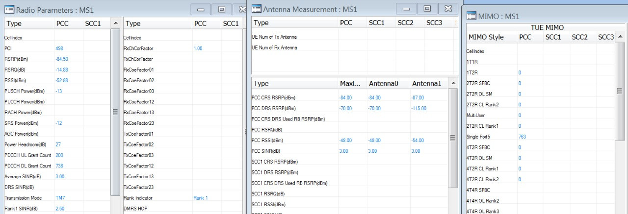

You may be in very good RF… :slight_smile:
Lte tm7, beamforming:
