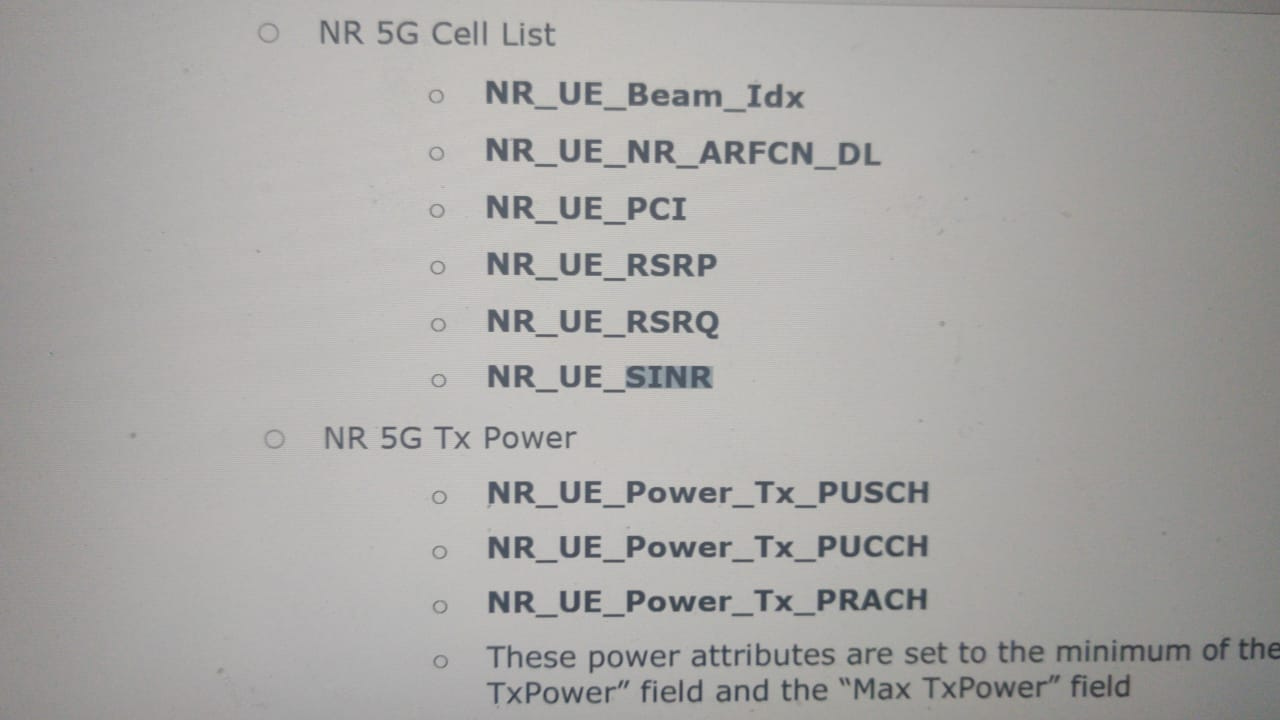

I think we dont have CSI-SINR KPI in Actix…
Yes correct @Vicky.
ps_sinr, ss_ sinr & ur sinr only showing…

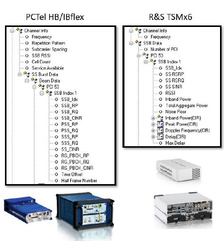

If you are using scanner you definitely cannot see CSI- parameters.
We have used Pctel and R& S scanners as shown above.
Which scaner are yu using?
Hi @eta004, I see, no CSI SINR field available on it… :frowning:
Using PCtel.
Why do you need CSI SNR not SS?
Yes Scanner purpose is coverage measurement, so SSB -parameters are good enough.
Also, CSI-SINR is not supported in X-50 Qualcomm chipset also according to my knowledge.
So You can’t expect it to show up in a passive scanner.

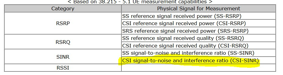

We would like to study b/w SSB_SINR and CSI_SINR difference in the network.
Also later need to Benchmarking.
Detailed study on SSB and CSI parameter.
Then please use UE for Drive Test.
