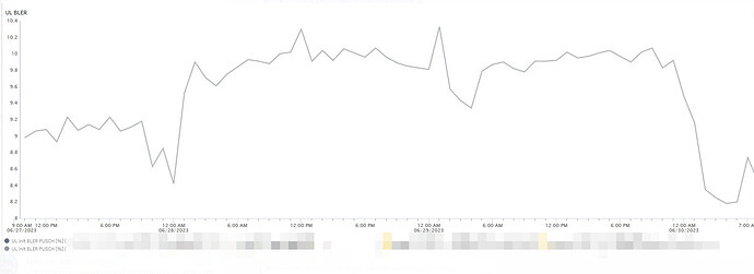

No change in the trend, not even %0.001.
What value pre and post?
Is it hourly?
10.01 vs 10.02, similar in all bands.
Prime time 16:00-18:00
Value too high for UL BLER.
It was around 8 - 8.5 before the activation of CLPC.
Looks like i solved it , last night changed, maxsinrtarget for clpc
First degradation is due to clpc activation
High BLER suggests UE transmitting with low power.

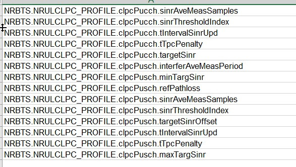

This is the full clpc parameter list:
