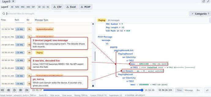

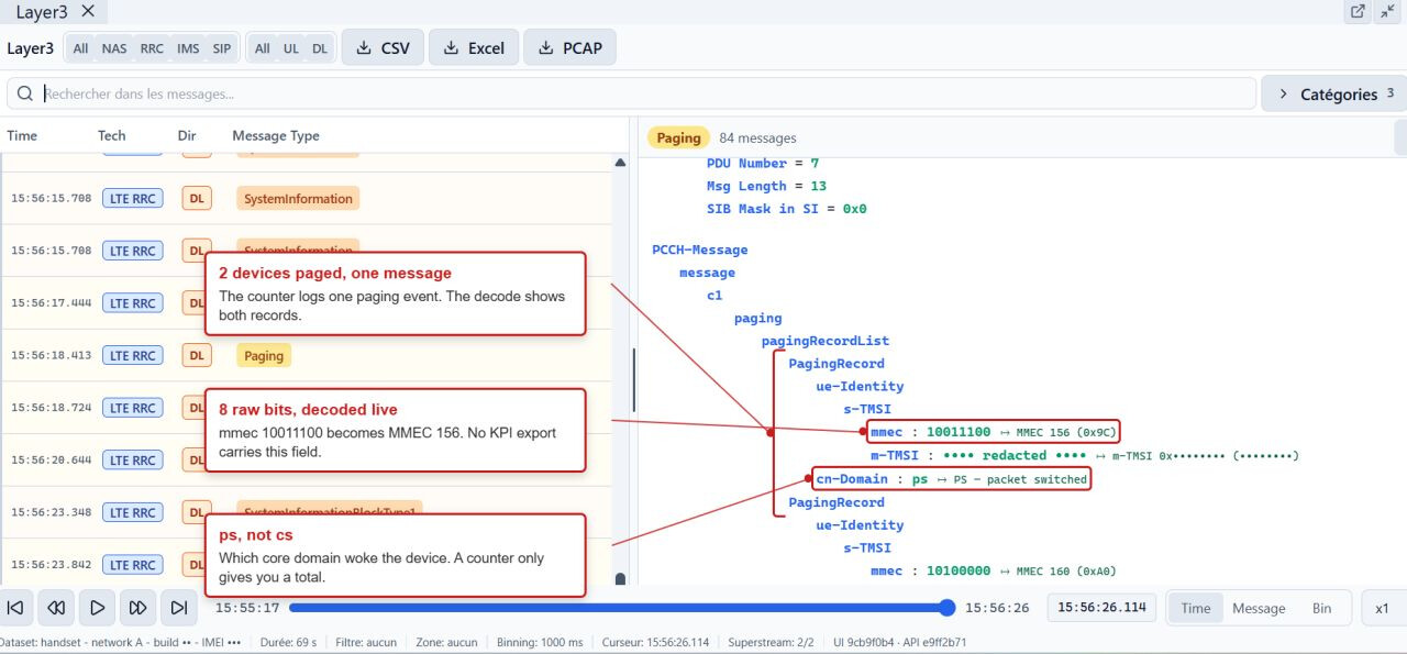

Open a measurement report and you find rsrpResult : 28. Twenty eight. That is the value the UE actually sent. Minus 113 dBm is the conversion, per TS 36.133. Most engineers I meet have never seen the left side of that arrow, only the right side, printed by a tool that decided for them.
