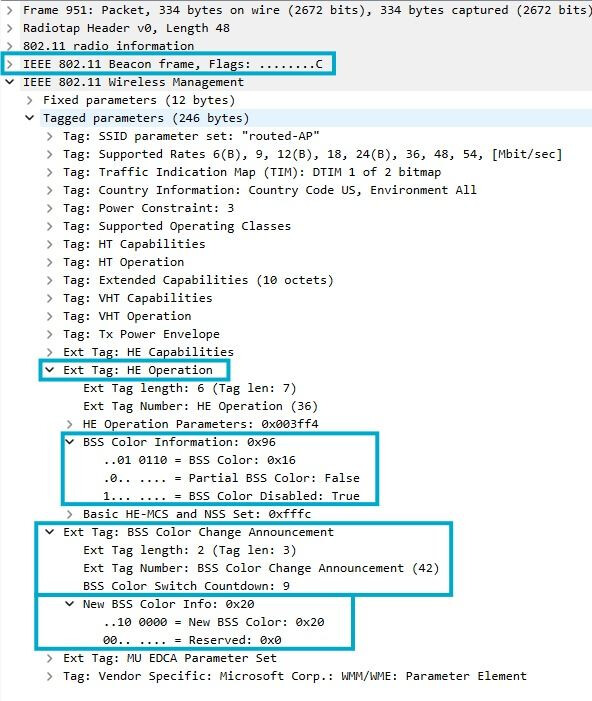

Before transmitting, a device needs to know whether a received frame is from its own network (intra-BSS) or from a neighboring network (inter-BSS). To help with this, BSS Coloring was introduced. Each AP assigns a color (a number from 1 to 63) and includes it in beacon frames.

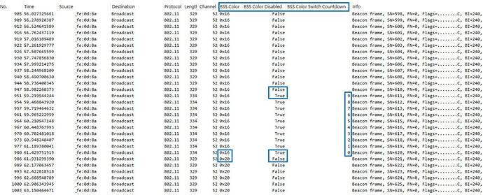

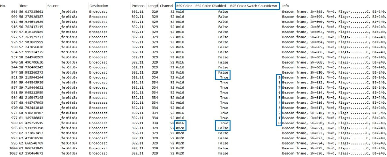

If two BSS choose the same color, a color collision occurs. In such cases, the client devices treat each other’s traffic as if they are in the same BSS (Intra-BSS) rather than an overlapping one (OBSS). The AP detects such collisions by observing frames with the same color but different BSSIDs.
The AP then selects a new color from the available range (1 to 63) and announces the change through beacon frames using the “BSS Color Change Announcement” sub element that is present under the HE operation IE and contains the new BSS color information. Along with this, a “BSS Color Switch Countdown” field is included to ensure that all associated stations transition to the new color synchronously. During this transition the “BSS color Disabled” bit is set to true to temporarily disable color-based spatial reuse.
