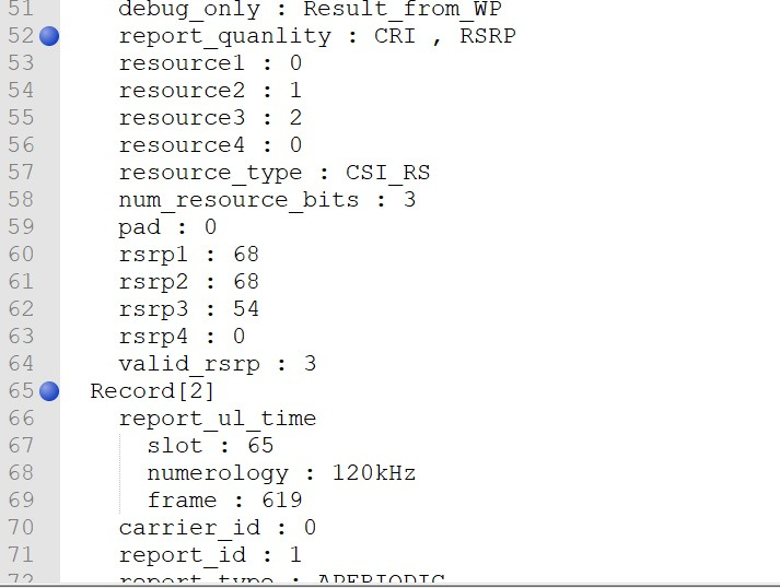

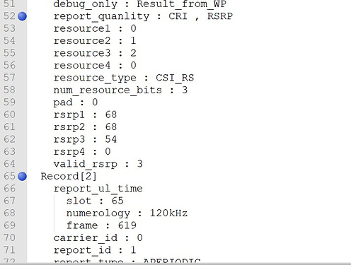

Do you mean there is no CSI-RSRP for FR2?
I mean no CSI-RS beam.
CSI-RSRP is measured from CSI-RS beams…In that case this is not right.We have CSI-RSRP reported for mmwaves.
The snap showed for MAC CSF info is of mmWave.
Already we have 32 ssb beam for FR2 how can it possible to use refined beam further narrow beams.
Please share snapshot where you have seen with FR2.
I think you’re seeing cri only…
No, It’s CSI-RSRP itself.
There are upto 4 resources for CRI and the best of these 4 will be selected by gNB to communicate to Ue using CSI-RS beams.
