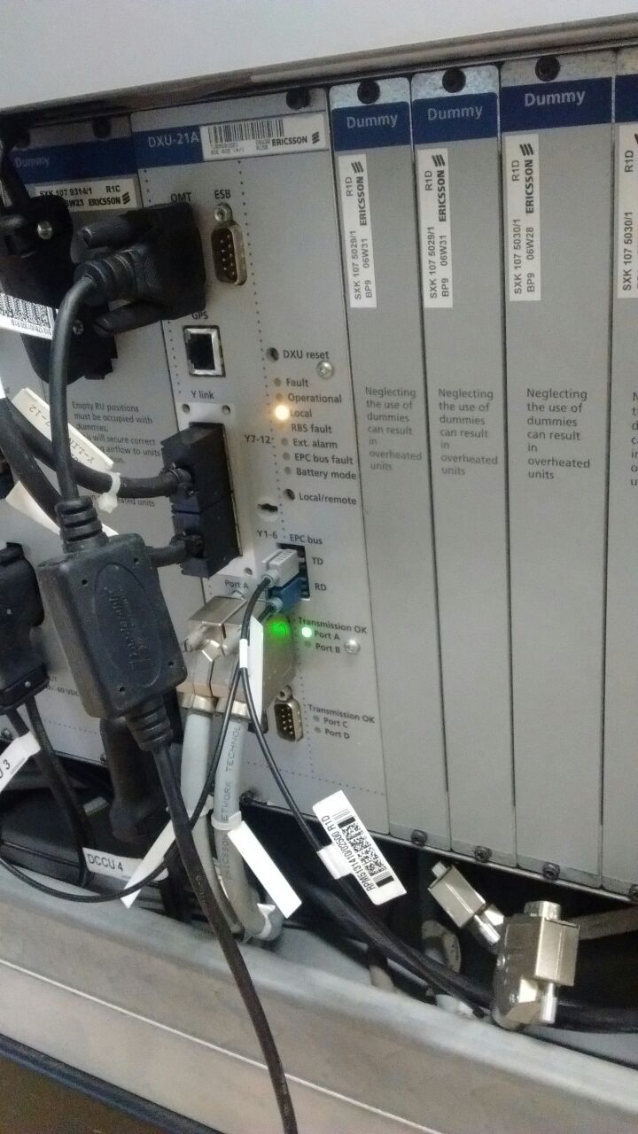

You can get a DXU that is working and then u compare the config
Does the DXU light show local or operational
Local. I suspected DXU, but the local technician relocated the same DXU on another site and it worked, and the configurations were tested and passed on ok.
So can’t take the DXU on the working site test on the site with a problem?
Led blinking
Code EC1 4
Is the light not stable yet?
No. It may be faulty!

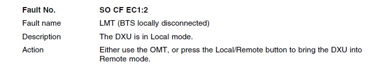

Share alarms again
Fault No. SO CF EC1:4
Fault name L/R SWI (BTS in local mode)
Description The DXU is in local mode and cannot be controlled by the BSC.
Action Either use the OMT, or press the Local/Remote button to bring the DXU into
Remote mode.
